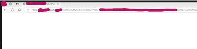

    This is the original screenshot from the end user. Description: "After log-in I get a white screen in both Firefox and Edge."
    I think what people do looks something like this:
    1. They open the official recommended link
    2. They ignore all my "Important Notes" in the invitation to only store the official recommended link (important step!)
    3. Login page appears. Browser redirects to the shown URL
    4. People bookmark the page.
    5. After login they would get the regular link again. But it´s already too late.
    6. People can access Innovator with the "wrong link" for a certain amount of time without any problems, but sooner or later they will get the white page.
    I don´t know the exact time frame. But I know that I had douzends of affected users so far. It´s a more a meme bug, cause people could have avoided it by just *reading* the official first invite.

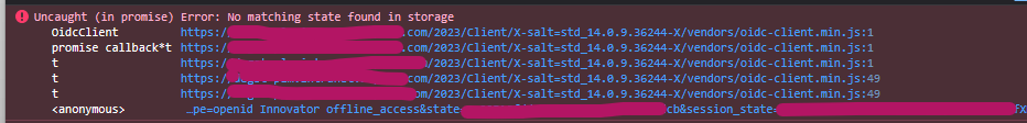

    3. After login I get the white screen and following message in the browser debugger.
    4. I noticed that the URL in Firefox has changed again and now contains the state and session_state variable.
    https:  //xyz  /2023/Client/OAuth/RedirectCallback?code= ---- &scope=openid%20Innovator%20offline_access&state= ---- &session_state= ----
    These two values are probably outdated or don´t exist in the Firefox cookies. I don´t know, I haven´t checked them yet.
    After this test Innovator in Firefox works perfectly with the correct link. It's really not a big issue and I don't need a quick solution here. But let me know if somebody has an idea to improve the situation.
