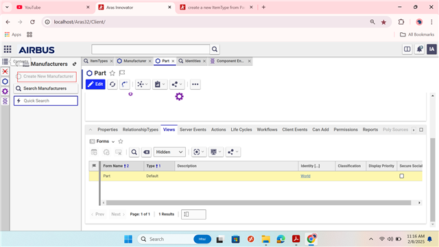

  • Hi, My Manufacturer create button has disabled and I am not able any item coming under sourcing category Aras release 32
     ,Please help me. Thanks
  • Hi Ananta,
    I think your question is of topic from the original question.
    But long story short.
    I think your permissions are not set in such a way that Innovator Admin can create a new Manufacturer.
    For these kind of problems you best go to the ItemType (in this case Manufacturer) and then to the Permissions tab. Then open the permission to see which Identities can do what.
    Hope this helps,
    Eric
