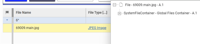

But we have another type of files -> images and thumbnails. If thumbnails are not referenced any more, they are not marked as orphaned. They stay in the Global Files Container. We cannot use the locator to check if the files are still used.

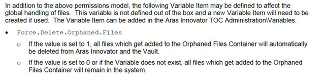

    The "Delete.Orphaned.Files" Variable unfortunately doesn´t seem to work for files in the "Global Files Container" like thumbnails.
    As mentioned in the description, the Variable only applies to files in the Orphaned Files Container (=related files).
    That´s why deleting thumbnails is a super dangerous task in general. You can just go to the "Files" ItemType and delete them. BUT: You will never get any warning when they are still used somewhere. They aren´t tracked by the file locator at all.

  • Which Innovator version do you use?
    In I12 with (enable force delete variable!), when i create a part with a thumbnail, and then delete the Part, the file will not be removed.
    In I12, all files related to a property of type "Image" will only be stored in the Global Files Container.
