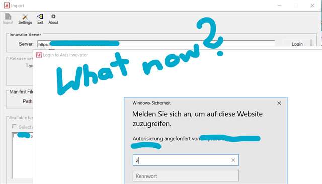

I want to upload a small package with the Import Tool. I did a test run first with a test database, that is on the same server as the target database. The test was successful. I now want to import the same data to the target database.
Now the fun part:
The modern WebView2-based high-tech "Import Tool" doesn´t allow me to switch the database. I get automatically logged in to the test database as soon as I entered my credentials. It´s seems that the session cookie is reused. Typically the preferred database is also stored in the cookies.
It´s no problem to delete the cookies in a regular browser. But how can I delete them in the Import Tool?
I have a couple of Import Tools, so I can also use an older version. But I wonder if there is a more elegant solution available.
Or do I really have to "wait" for the cookies to expire? The database cookie ist stored for 30 days.... Slight smile

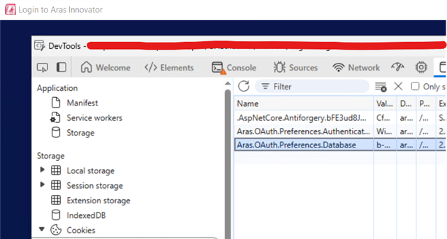

    One thing you can try to clear these cookies to get around this issue is to bring up the browser dev tools when you are brought to the login screen. You should be able to do this by either clicking F12 on your keyboard or by right-clicking and selecting "Inspect" (or whatever the German equivalent is). From the dev tools, you should be able to clear the cookies. In the Google Chrome dev tools, you can find your cookies by going to the Application tab in the top row.

    Yes I use active directory! I made short video to show the real-life situation: https://www.youtube.com/watch?v=ILRCcWhpPlY
    Target version is I12. But I use the latest export/import tools cause they support language packs a lot better than the previous versions.
    The F12 trick worked! Innovator ask me for database selection again as soon the cookies were deleted:
    Thanks for this tip! It´s definitely more convenient that my current work around - using 3 different generations of Import Tools....
