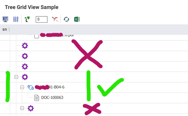

So my idea is right now to use TGV for the tree rendering. I made a very test with QD and TGV. Data is missing intentionally as it´s just a functional sample. TGVs work well for trees, but they will show the complete BOM structure. Is there any way to hide the data we don´t need?
We can use parameters to filter the data. But this filter option currently only hides the text of the elements and not the complete grid row itself.
This behavior probably has a reason. In a multilevel BOM scenario Innovator cannot tell on which BOM level we have documents. TGVs need the complete data for the rendering. But I would be awesome if we would have some additional filter options to play around with appearance of the data AFTER query execution.

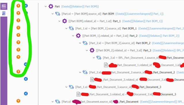

    The original idea was using a self-repeating multilevel query like this:
    But using "exists" in this context doesn´t work properly. Deeper levels are cut when upper levels don´t contain a document.
    What DOES work is something ingenious like this:
    The highlighted green stuff are the "exists" filters. Sunglasses

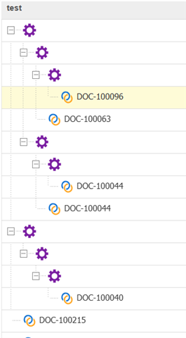

    This one gives this result:
    Pro:
    - It´s a proper tree, even with the intermediate levels!

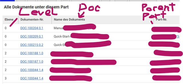

    So far I already used an SQL based solution for these kind of renderings.
    That is my current flat view.
    Con: It doesn´t list the intermediate levels. Users don´t see, how the data is connected.
    Pro:
