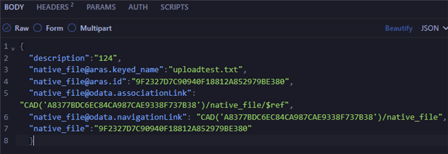

I tried this old sample of mine and it worked fine:
If it works for you, please tell me which parts of the body are actually needed .
The tag "native_file" works, but "[email protected]" does not. I was using the latter because that's exactly what the results from GET looked like.
Thanks.
