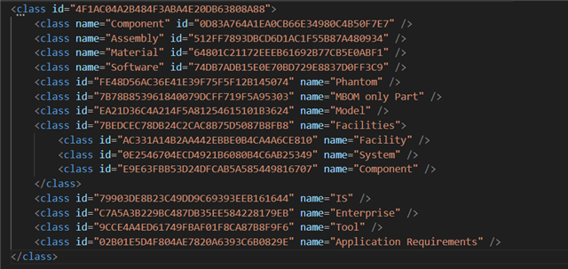

    It appears that the class_structure property on ItemType is a Text field. Here's what it looks like for the Part ItemType:
    I believe your issue is that you're treating the XML within the class structure as an extension of your AML, when in reality it's basically a long string within your class_structure property. I've created a basic ItemType with a modified class structure and exported it via the export tool. Here's how it looks:
