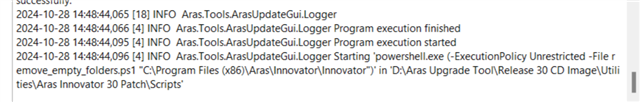

I'm upgrading the aras version from 29 to 30. While following the aras upgrade tool. I'm stucked at one point.
The log file show's following image. Could anyone help me in this please?

Hello Soham,
Generally this issue can arise because of limited permissions. Ensure you're running Aras Update as an administrator. Also it can be related to your ExecutionPolicy for your local user or machine. Take a look at this post about updating the ExecutionPolicy: https://superuser.com/a/106362
I set the powershell policies to unrestricted but still...the process is getting stucked at the same point. Could you please help me ?
Hi Soham,
Normally setting the policy to unrestricted has solved my issues. I'd recommend reaching out to Aras support to see if they have another solution.
