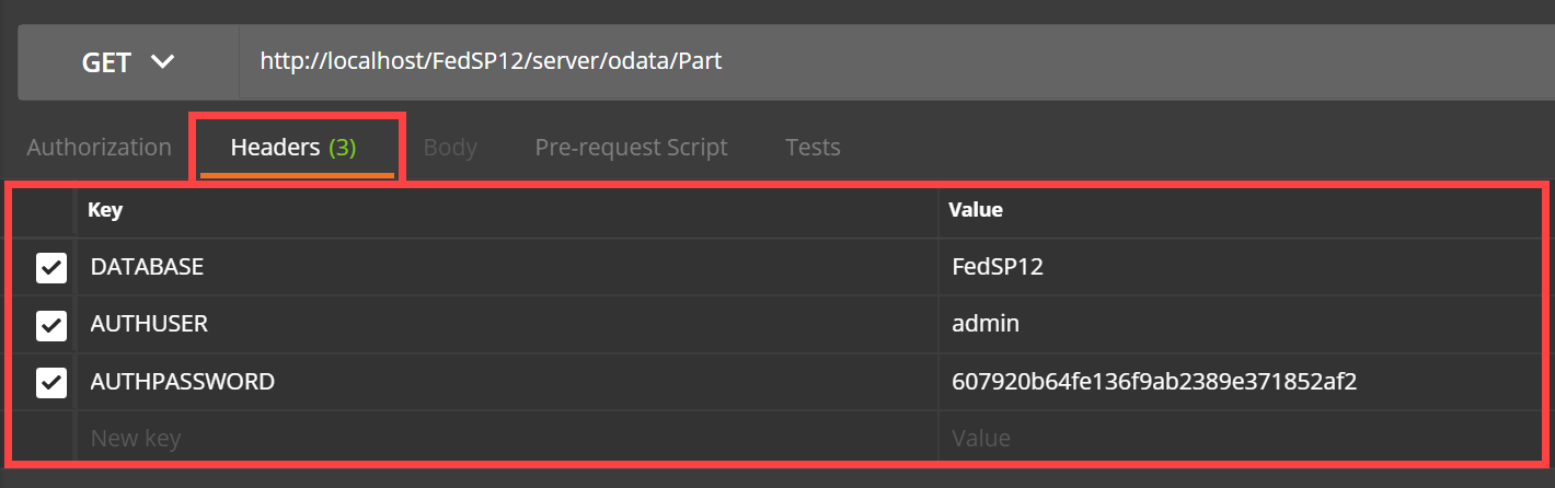

A successful API call to Aras Innovator requires four key pieces of information. First, you need the url for your Innovator instance's OData service: http://{server}/{web alias}/server/odata. For brevity, we'll call this the "base url" in this post.
You also need to include the following headers for authenticating the request:
In Postman, you can add the headers to your request under the "Headers" tab.
[caption id="attachment_11439" align="alignnone" width="1420"] Screenshot shows the required headers entered in the Postman client.[/caption]

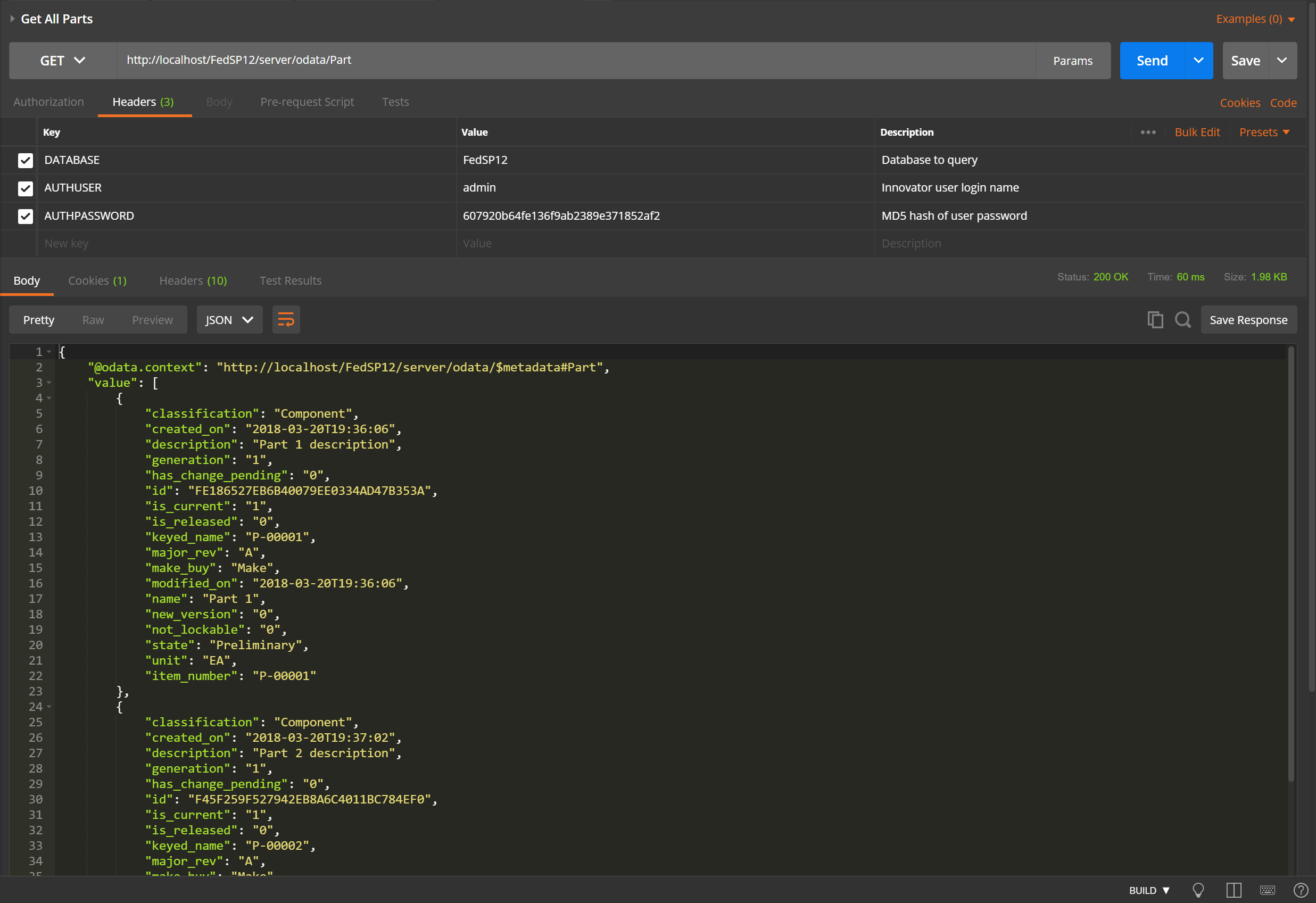

The most simple GET call retrieves a collection of all items in an ItemType. For example, I can retrieve all Parts using GET http://{server}/{web alias}/server/odata/Part.
[caption id="attachment_11440" align="alignnone" width="2473"] Get all Parts using the OData request url "http://{server}/{web alias}/server/odata/Part".[/caption]

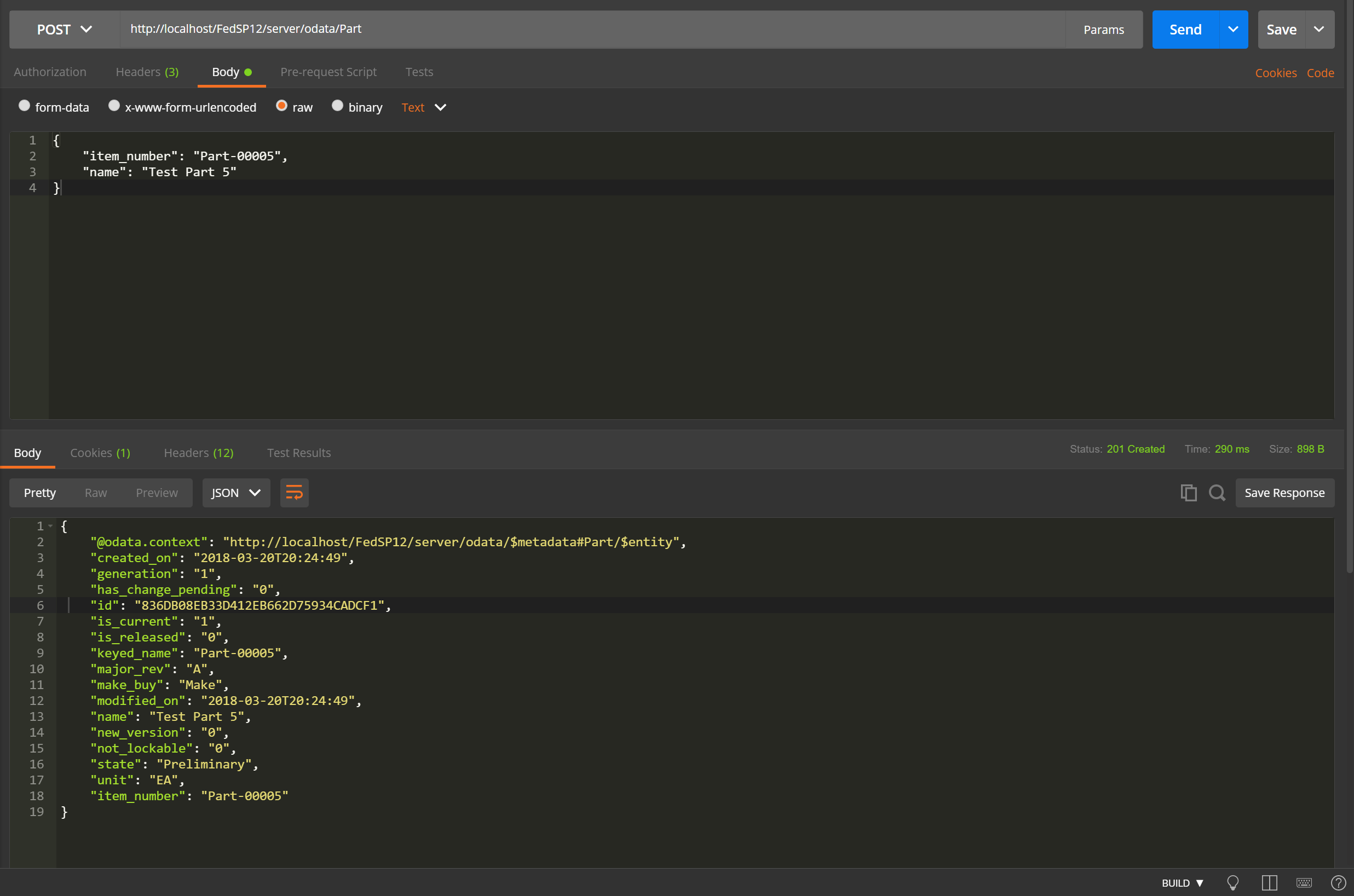

To create new items in Aras Innovator, use the "POST" HTTP action and include the new item's properties in the request body.
[caption id="attachment_11441" align="alignnone" width="2473"] Create a new Part with the "POST" HTTP action and required properties in the request body.[/caption]
POST {base url}/Part
Body:
Result:

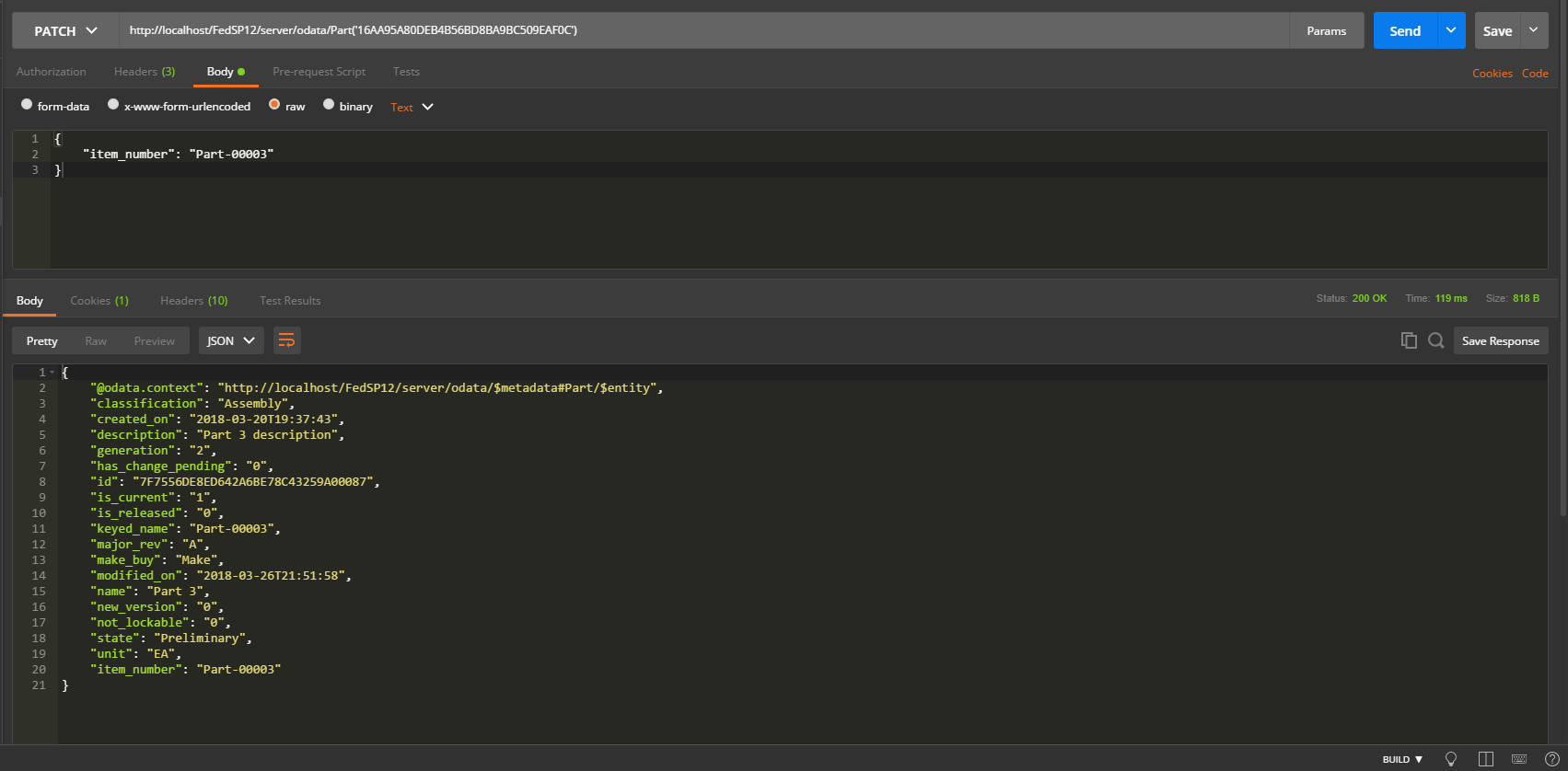

To update an Aras item, use the "PATCH" HTTP action and include any properties you want to update in the body of the request. Be sure only to include updatable properties, or the request will fail.
[caption id="attachment_11442" align="alignnone" width="1703"] Updating Part number P-00033 to fix the item_number property.[/caption]
PATCH {base url}/Part('16AA95A80DEB4B56BD8BA9BC509EAF0C')
Body:
Response:

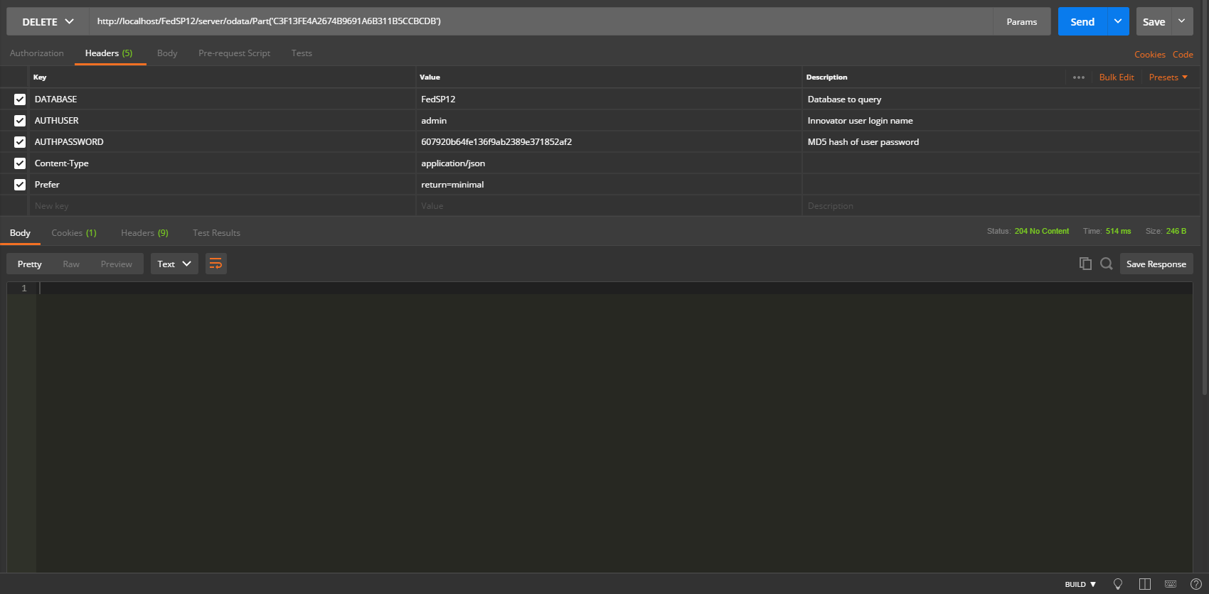

To delete an item using the Aras RESTful API, you can use the "DELETE" HTTP action. Be sure to include the id of the item you want to delete.
[caption id="attachment_11499" align="alignnone" width="1700"] Deleting a Part by id.[/caption]
DELETE {base url}/Part('C3F13FE4A2674B9691A6B311B5CCBCDB')
Both the request body and response are empty when deleting an item. Note that you can only delete one item at a time.
Did you get a 405 HTTP error when trying to delete an item from Innovator? This may happen if the WebDAV module in an out-of-the-box installation conflicts with the RESTful API. To resolve this error, you can try the following steps.
Setting Up the Call
- DATABASE: The database you want to connect to
- AUTHUSER: The Innovator user name you want to use to connect
- AUTHPASSWORD: The MD5 hashed password for the AUTHUSER
Important Note!
The AUTHUSER used in the request header will be used when evaluating user permissions in Aras Innovator. If you try getting or editing items that the AUTHUSER does not have permission to get or edit, you will receive an error or "No items of type {ItemType} found" in the call's response. Similarly, if you hard-code the root or admin user as shown in this blog, you may inadvertently expose data that not all users should be able to get and edit.
Getting Items

Creating Items
Create a new item
Body:
"item_number": "Part-00005",
"name": "Test Part 5"
Result:
"@odata.context": "http://localhost/FedSP12/server/odata/$metadata#Part/$entity",
"created_on": "2018-03-20T20:24:49",
"generation": "1",
"has_change_pending": "0",
"id": "836DB08EB33D412EB662D75934CADCF1",
"is_current": "1",
"is_released": "0",
"keyed_name": "Part-00005",
"major_rev": "A",
"make_buy": "Make",
"modified_on": "2018-03-20T20:24:49",
"name": "Test Part 5",
"new_version": "0",
"not_lockable": "0",
"state": "Preliminary",
"unit": "EA",

Editing Items
Update an item
Body:
"item_number": "Part-00003"
Response:
"classification": "Assembly",
"created_on": "2018-03-20T19:37:43",
"description": "Part 3 description",
"generation": "2",
"id": "7F7556DE8ED642A6BE78C43259A00087",
"is_current": "1",
"is_released": "0",
"keyed_name": "Part-00003",
"major_rev": "A",
"make_buy": "Make",
"modified_on": "2018-03-26T21:51:58",
"name": "Part 3",
"new_version": "0",
"unit": "EA",
Deleting Items
Delete an Item
405.0 - Method Not Allowed Error
- Back up your code tree and save the copy in a safe place.
- Open IIS on the server.
- In the Connections pane, navigate to the Server sub-application of your Aras Innovator instance.
