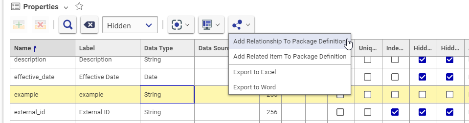

Once we've created the property, we can prepare it for export. We can add our property to a PackageDefinition by using one of the new actions made available by the cui-add-to-package project. Since properties are a null relationship, we'll choose to add the relationship to the PackageDefinition. It is also possible to open the example property and run the action from the property form.

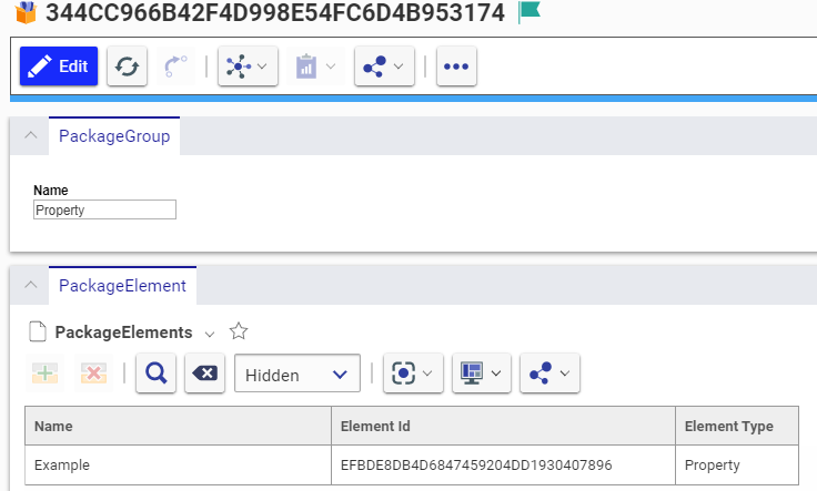

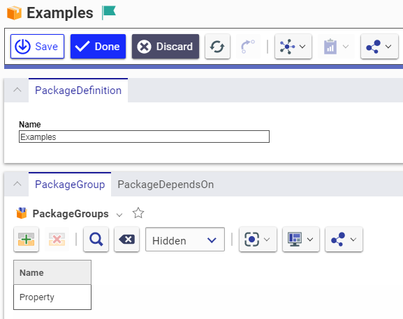

Since this is custom development, we’ll add our changes to a new PackageDefinition “Examples”. The action will automatically create a PackageGroup within our PackageDefintion. If you go to look at your PackageDefinition or PackageGroup, they should look like the screenshots below.

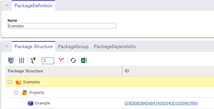

Here's the same PackageDefinition shown using the tree-grid-view-sample project. This shows more clearly how a PackageDefinition is structured.

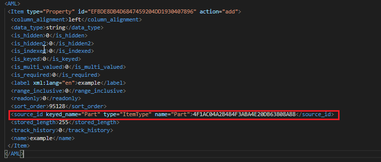

The property item will be added to the PackageDefinition upon export. If we look at the XML which is produced, we can see it is linked to the ItemType by the property "source_id", and therefore will be added back to the correct ItemType on import. The same would apply for any relationship, such as a list value, permission, or TOC Access.
