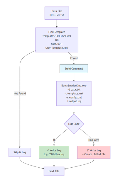

How the pipeline works
Each data file goes through a simple but robust processing pipeline.
The script locates the appropriate template, builds and executes the command, and logs the results.

File naming conventions
Use a simple, lexicographical naming convention so the script processes files in the correct order, especially when dependencies exist between items and relationships.
Hard requirements: Template name must match the data file’s base name (stem). The script looks up the template by the data file’s stem and skips the file if no match is found.
Processing order: Normal mode loads data files in ascending lexicographic order. Use zero‑padded numeric prefixes to control sequence.
Recommended order for multi-step loads:
  1. Parent/base items (e.g., Parts)
  2. Child/related items (e.g., Documents)
  3. Relationship files last (e.g., Part‑Document relationships)
Delete mode reverses the order automatically so relationships are removed before their related items. Retry mode processes *.failed files alphabetically as well.
